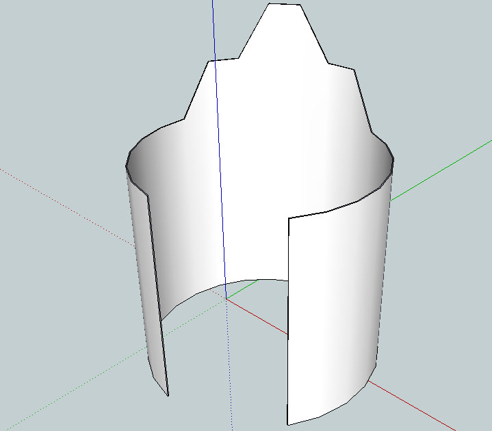

      Hey, im in the construction industry and am currently building some unusual objects. I've been thinking of using sketchup to help my plan some of the things im building. My issue is that when im modeling something curved in sketchup, i'd later like to flatten the curved object to a sheet, so this would then give me the flat dimensions so that i could cut this curve of of a sheet of ply in real life... confusing huh?
      See attached file... Now if i wanted to convert that curve into a real world piece of ply i'd need to flatten that curve without loosing any of the correct curve dimensions. Can this be done easily? plugin maybe?
      I hope someone understands what im trying to get at here, and any help would be greatly appreciated.

        I think this will do what you need.
        http://forums.sketchucation.com/viewtopic.php?f=323&t=24593
        By: Kristoff Rand
        • gillesG Offline
          gilles
          For this kind of job I use Unfold.rb.
          http://sketchuptips.blogspot.com/2007/08/plugin-unfoldrb.html
          Make your shape without thickness and turn on hidden geometry.
          • mitcorbM Offline
            mitcorb
            If you just need dimensions, another way would be to select the circular edge, right click, Entity Info and check length. And you can do this for all other edges. But the other ways offer more info.
              Like Gilles, I would use Unfold.rb. Keep in mind however that since your SketchUp model only approximates the circle so if you need higher precision from the plywood, you'll want to increase the number of sides you use for the circles or arcs you draw.

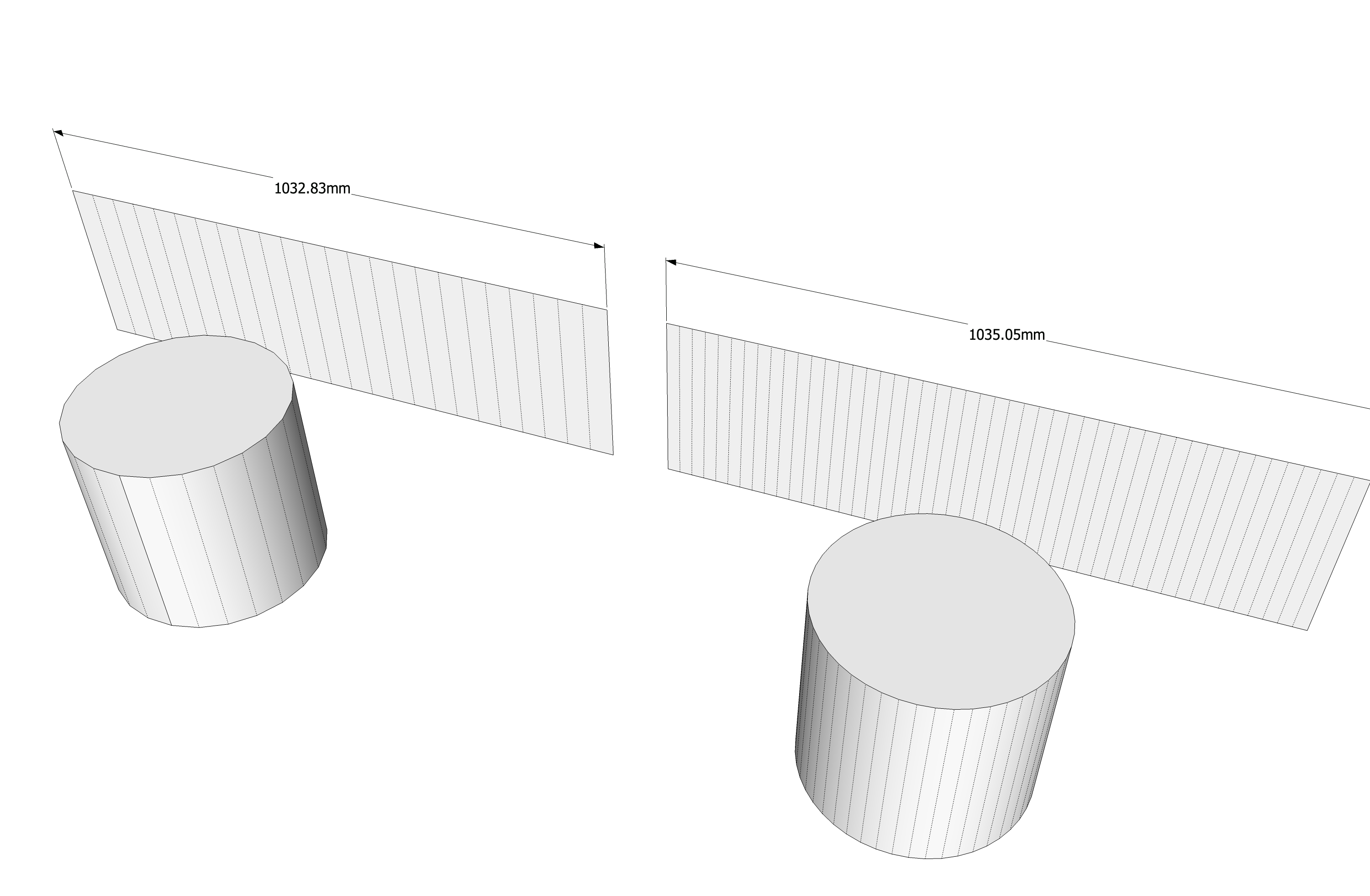

                      As you have unfold the inner shape make a copy of it, find the outer curve length and scale the copy to fit this length.
                      NOTES:
                      as SU draw segments not real curves you may have to calculate the real length by hand.
                      as you want to make accurate product I would draw the shape flat then bend it.
