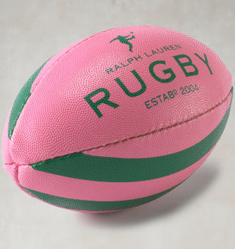

            This is what you want right? (excuse ralph lauren ball, but it was first image I found that looks like what you need).
            The indentations are the 'ribs'?
            http://4.bp.blogspot.com/_A2sH6UV9KQ8/SLXvNTdTQbI/AAAAAAAAAlY/jb4543mj8fc/s400/rugby+striped+mini+rugby+ball.jpg

              Jsketch
              yes exactly
