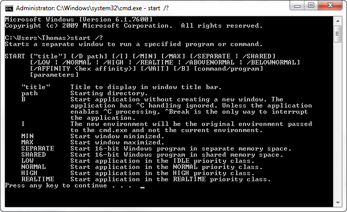

                              I looked at the help information for start:
                              Turns out the first argument must be a title - for that command window that briefly flickers.
                              Not sure if this works under OSX though.

                                  I see that your version of DOS is 6.1. Is this its original release, or the one that came with your WinOS? Which machine were you on at the time? I have a copy of DOS 6.1 (left over from the good old days) installed in a VPC.
                                      FYI ... DOS 6.22 came out at the same time as Win 3.11 for Workgroups (I still have my disks and manuals as well.) DOS 7 was distroed with Win98 (not sure about Win95.) Win 2000 & up are NTFS not DOS.
                                      BUT ... you misread the image. It is the Windows ver that is displayed, not DOS.
                                      Win 5.0 = Windows 2000
                                      Win 5.1 = Windows XP
                                      Win 6.0 = Windows Vista
                                      Win 6.1 = Windows 7
