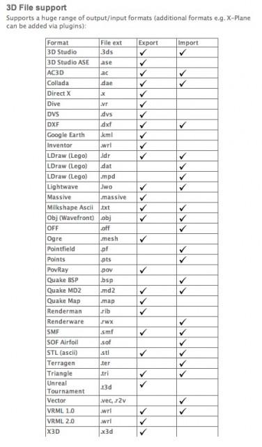

      I am very impressed with the the 3D File Support which looks to be very comprehensive.
      Mike
      • TIGT Offline
        ... and it has many import / export formats too...
        One to watch... ☀
          Including Lego! 😲 😆 😄
