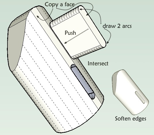

        For the grip
        Show hidden geometry
        Duplicate and move a face
        draw the surface needed (2 arcs)
        push it for build a volume (if you want many grips you can reuse it πŸ˜‰
        move it inside
        Intersect
        kill that you don't want
        et voilΓ  πŸ˜„
        Ps That is an exploit for me: I have not used use any plugin ! πŸ’š

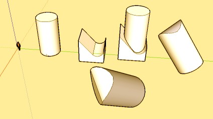

          Just use intersection of Volumes
          one cylinder
          One face with profil then Push it
          Select all
          Intersect selected
          Kill that you don't want
