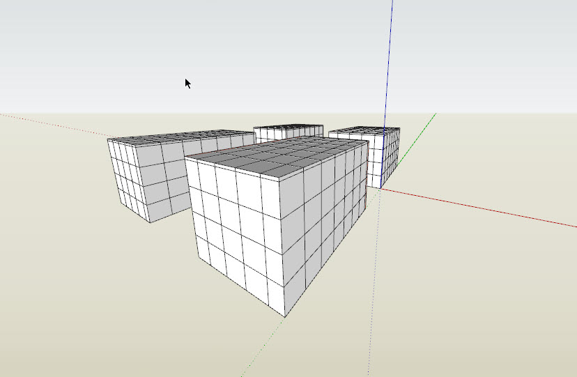

      Hey I am illustrator for various comic book companies and for years now I have been drawing all of my background work by hand, now that I am trying to use sketchup to improve my work flow I have hit upon a few problems.
      1. Is there a way to add a perspective grid to every component in a model with out doing by hand?(This is what I have been doing with the google "Grid" plug-in) It is very tedious and laborious when applying it to entire cityscapes.
      2. When I create a style it never saves all of the options I have, I still have to turn off shadows and turn on hidden geometry. Nitpicky I know but is there a way to simplify this?
      What I am looking for is clean detailed black and white line drawings to use in my work.
      Any help would be very appreciated.

          What I am looking for is a way to(for example a simple city scape) add a perspective grid that wraps around the entire component(s)in the model almost like a grid texture, so I can use that to add detail when I take the printed out 2d graphic and light box it into a finished page of artwork. Also If I could change the scale of the grid that would be key.

              I'm suire it makes sense in your head, but I'm sort of lost for precisely what you want. Do you want it just around the components bounding box? Or a full 3d grid of lines throughout the component? Or is it really a material painted onto the surface of the component only? - that requires UV coordinates which is a totally different problem!, os really just a screenshot of what you have or what you are thining of would really go a long way to help clear up the picture in my mind. Thanks!

                you could try slicer ruby. is this what you want?

                  That is exactly what I am looking for, does that work in hidden line view or does it work as a texture?

                      Yeah, slicer! I think that is a good fit for what you are looking for Kris. I hope it works well.

                        would be nice if someone chris would modify the code for you so that it did x,y,z all at the same time and didn't make internal faces. 😄

                          I agree but it quickly does the trick, I am using both methods for various pages. I'll show an example or 2 when they're done.
