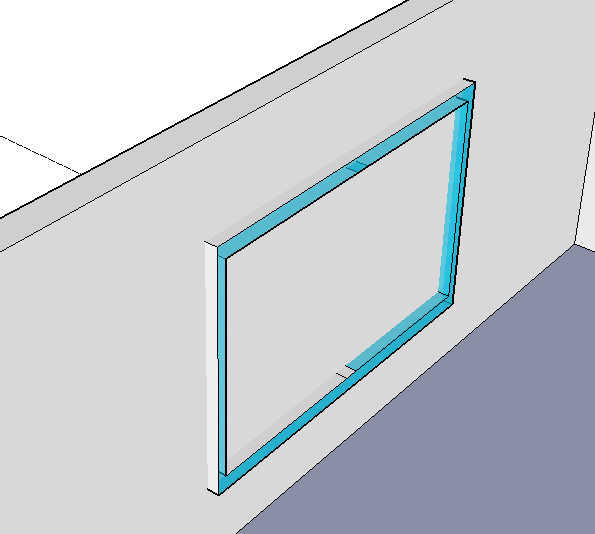

                  I modified your model. Now the frame pokes all the way through the wall, but still doesn't cut a hole all the way through. See attached GIF. This is the view from inside.
                  From the outside I can see through the glass and am actualy looking at the outer surface of the inside wall. So it's cutting a hole but only through the outer wall surface not the inner, even though the frame penetrates all the way through.

                  • GaieusG
                    See, Greg, this is why the actual example is needed.
                    As for components cutting through thick walls - it is not possible at the moment. They can have only one axis system thus one gluing and cutting plane.
                    There are workarounds however - you can intersect the inner face of the thick wall with the component or use some truicks. I have "compiled" the experiences and "tips&tricks" of "generations" of SU users in a little tutorial here. One will find out these techniques by him-/herself sooner or later anyway so it is just like re-inventing the wheel but a forum is just to learn from each other.
                    Here is an example file I uploaded into the warehouse (read the description on how to enable double cutting "effect" - as it is not reall cutting double bey on its solo self). Another example without making a parent component - just placed two components mirrored on the two, opposite faces.
                    Finally another "trick" in a video here - wonder if you figure out how I made it πŸ˜‰
