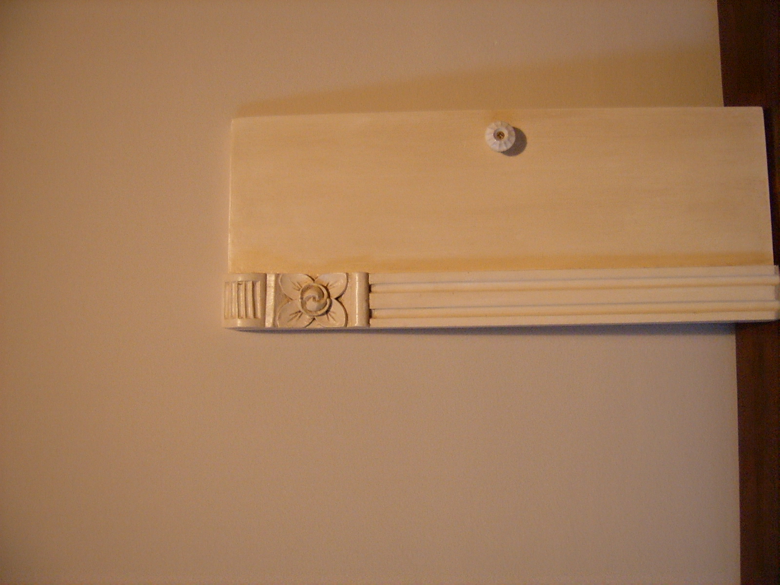

      Hello!
      I'm new in sketchup. I would like to draw handmade furnitures. I manage it a little bit but I have some problems with a woodcuted flower. De flower is on a curved surface and I dont have any idea how to draw this. Could you help me please. I attached a picture about my litle flower. Thanks a lot.

        Try searching simon le bon, and look for I think the post was called Gothic Panels. It will give you a good start and let you know the best rubies for some of what you wish to do.

          Here is the topic in question:
          http://forums.sketchucation.com/viewtopic.php?f=18&t=9781

            Which is becoming a bit old, and a bunch of new ruby tools can probably help a lot to master this kind of job.
            I think of:
            • A difficulty is the heavy work of cleaning unwanted geometry.
            a tip: Grouped Erase
            an extraordinary selecting tool: Selection Toys (2.0.0)(wich can make selection or unselection into a selection)
            by the same man: Cleanup (1.1.2)
            • Difficulties to draw bended and sails shapes:
            Shape Bender Beta v0.51
            by the same man: Simple Loft alpha 0.1b
            FredoScale 2.0h
            extrudeEdgesByEdges.rb v1.8
            *Difficulties with FollowMe operation:
            Perpendicular Face Tools(it is very tedious to draw a perpendicular face at the end of a curve in order to start a FollowMe operation)
            FollowMe and keep(When the curve path joins two levels, FollowMe tool makes the face rotating. This tool soluce this)
            follow me rotate by the same man
            RoundCorner 2.1c(1- not exactly a followMe tool but in the same family; 2- a considerable enhancement of Round Edge by the same man.
            difficulty to assemble pieces (boolean operations):
            BoolTools(commercial)
            Boolean--OSCoolean Beta(free but buggy)
            difficulty to draw on an organic face:
            Tools On Surface - v1.5f
            difficulty with construction points
            [url=http://forums.sketchucation.com/viewtopic.php?f=180&t=13077:3tsf7h1x]Point v1.2[/url:3tsf7h1x]
            I forget certainly some...
            ๐Ÿ˜‰ simon.
