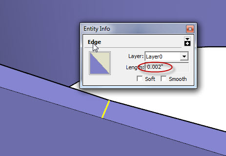

        you have a group hidden in there, explode it. then before you pp hit ctrl so you have a plus sign by your cursor. this will create a new face.

          i didn't realize how small this gap is till i took another look. SU definately doesn't like this. scalle everything up at least 10 maybe 100 times then perform all your operations before you scale back down.

            Thanks! I found that group and exploded it, and used the ctl trick. That seems to have fixed the problems. Where did you find that gap you mentioned, though?

              i guess gap is the wrong term, i meant distance from the edge of holes to outer edge.
