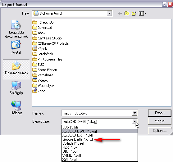

              I suppose it's the Google Earth (kmz) format then. Note that it is not necessarily evident as the Pro version has a number of different 3D export formats.
              Click on the image to see the pulldown menu in the screenshot
              Now for the kmz format, you cannot control how SU names either meshes or textures. Apart from groups and components, you cannot even give names to geometry in SU so you either follow modelhead's suggestion or find some other way to trick your export.
