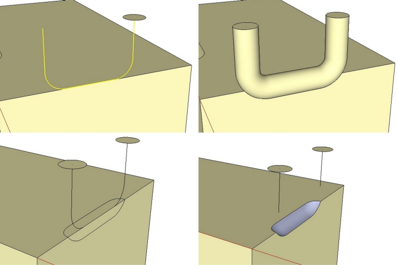

      Hi, I've been using Sketchup for a few months and I'm looking forward to getting better at modeling and appreciate all the help offered here. Can someone tell me what the term is for cutting out a notch like this and how I might go about doing it.
      http://i131.photobucket.com/albums/p313/shawn1270_photos/cutout.jpg
        I don't know the name, but you can make that with a boolean operation ๐Ÿ˜‰ I have made that by hands so right click/ "Intersect" ๐Ÿ˜„
        More easy with a plug ๐Ÿ’š
        A plug exists at Smustard.com Booltools by Dale Martens ๐Ÿ˜‰
        [flash=480,385:2x34nxzg]http://www.youtube.com/v/umcoC1JQAFQ&hl=fr&fs=1&[/flash:2x34nxzg]
        • R Offline
          REDnumber5
          Thank you, I was thinking about it all wrong, I'd drawn the lines and arc's and was thinking there was a way to somehow fill it in.

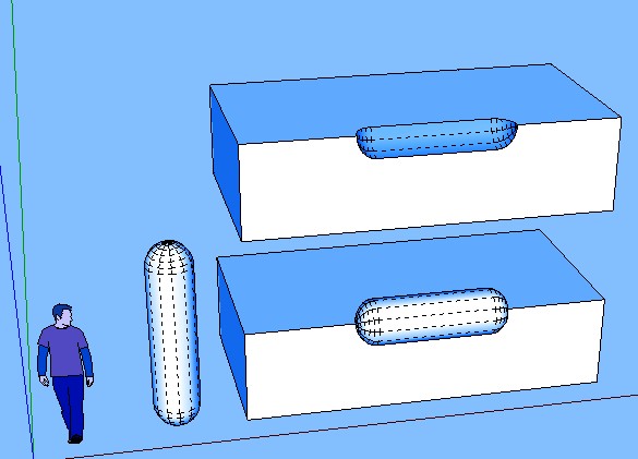

            The "capsule" is a cylinder + 2 half spheres
            If you want precision just draw more segments in drawing the half spheresphere.jpg

                Yup but you have also a capsule soon ready and parametric inside the Skechyphysics tools' plug ๐Ÿ˜‰

                  Here is the first thought I had. Draw the U shape, draw a cirlce and FollowMe along the U, Intersect and delete. But I am not sure if it is the right shape. If I made the arcs the same as the circle, then I think it would be OK.
                  Hi
                    Seems it's not exactly the same ๐Ÿ˜‰

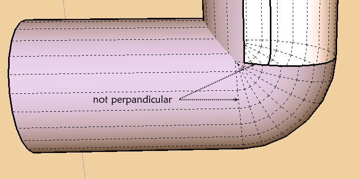

                      What if you make the arc radius 1/2 the circle radius?
                      Hi
                        seems that make not 90ยฐ between horizontal section and vertical section so can't be a 1/4 of sphere ๐Ÿ˜ฎsphe1.jpg
