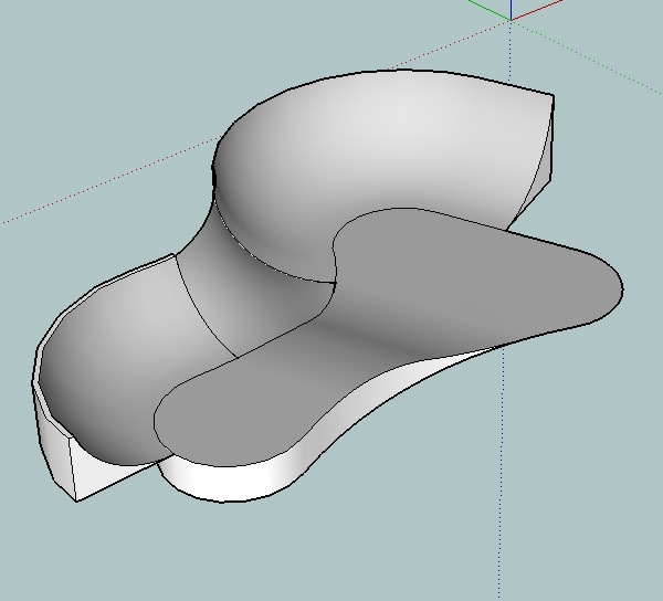

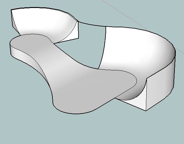

                        I think I am near the end but I always can't use SSB for the last two parts....
                        http://img6.hostingpics.net/pics/862263test6.jpg
                        if someone can tell me what is the matter, where is the mistake...?
                        near the end

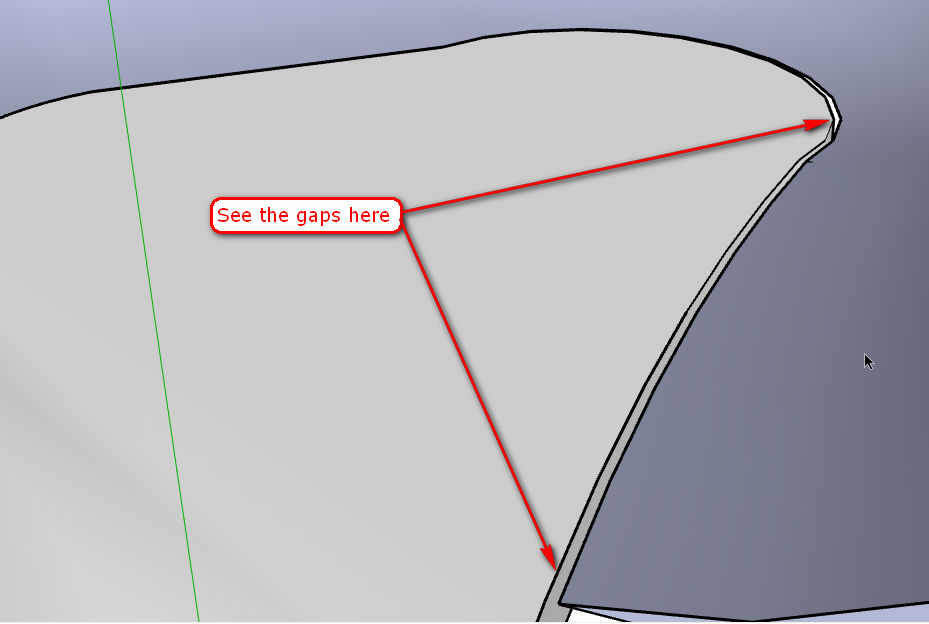

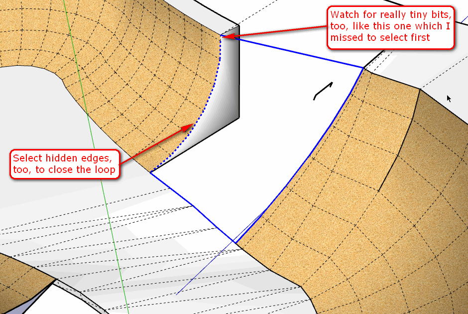

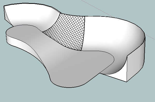

                            • GaieusG
                              Again, make sure to select allsurrounding edges to make a closed loop. In the model, on both sides, there are very little edge pieces at the ends and failing to select them for the SSB plugin will result an error message (I bet you kept receiving). Also make sure ti turn on hidden geometry to select those softened lines, too.
                              Other than this (probable) selection problem, I found nothing and could do the skinning fine. Note however that the top edge of your pool is not at the same height. This will cause problems when you want to fill it up with water.

                                ok i didn't know that we could have hidden edges, but for tiny bits, it is strange because I had green markers for placing my line that means that I am at an end point...
                                Good advices for me that mean that I need to be rigorous. So I m going to check all tiny bits 😞
