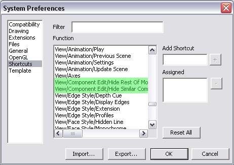

          You can also set it and "Hide Similar Components" as keyboard shortcuts:
          I use these constantly.
          Go to Window > Preferences:
