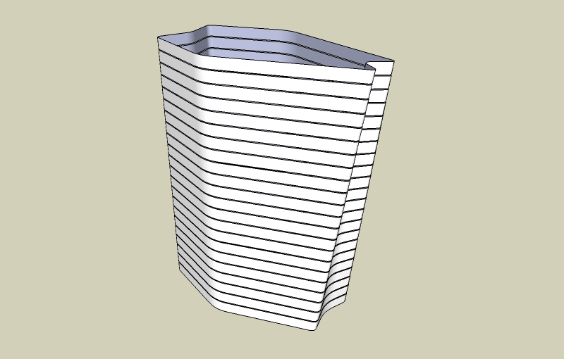

      Could someone help me or suggest a method to skin the exterior of floor slabs. the shape changes (at the front) from the base to the top. I am having a helluva of time and headache trying to do so. Follow Me just doesn't cut it.

          Thanks, but could you show me how it's done?
          • ely862meE
            ely862me
            u need this http://www.sketchucation.com/forums/scf/viewtopic.php?f=153&t=6912
            and later clean the unwanted lines
            anyway i think it was better if u used for first time push&pull and scale tools
