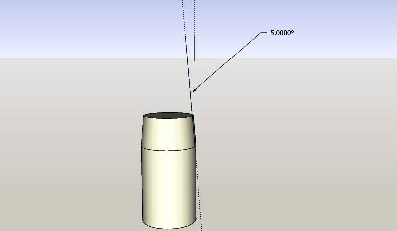

                Squeaky2011
                Sketch of Required slice
                • W Offline
                  watkins
                  Create cutting planes, then select the planes and the cylinder and then right-click>Intersect>Selected. Delete unwanted geometry.
                  The cylinder and cutting planes in the attached have been grouped. Explode them first before intersecting.
                  Wedge slice through cylinder.skp
                    OK, this is easy.
                    1. draw a circle and push/pull it up to the desired height.
                    2. draw a big rectangle on the same plane you have your circle (the edges shouldn't touch the circle)
                    3. move it up to the desired height (select it then press the up arrow key and you can only move it along the blue axis)
                    4. still the rectangle selected, place the rotate tool on one edge, click on it but don't release the mouse button yet. Start pulling the rotate tool along the edge. When it turns red or green (depending which edge you chose) release the left button and pick another part of the rectangle and start rotating it in the desired direction.
                    5. Now type 5 and hit enter.
                    6. Do the same (steps 2-5) for the other plane
                    7. Now select everything (the cylinder as well as both rectangles)
                    8. right click on the selection > Intersect > with model
                    9. the intersection lines will appear on the cylinder and you can delete the rectangles and all unwanted geometry of the cylinder
                    10. you will probably end up with one of the newly created faces being blue - right click on it and reverse faces in order to keep your model clean and tidy.
