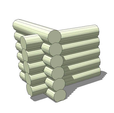

            If you are going to build the entire cabin log by log I'd strongly recommend that you limit the number of segments in each log to something like 12...as in my example. Otherwise you're going to end up with so many faces your model is likely to grind to a halt. The ends may look a little clunky, but as you can see, if you turn Hidden Geometry off, the logs themselves still look perfectly round.
            I think the construction sequence in the file is clear enough. One thing to watch out for is the fact that the semicircular "bite" at the end isn't actually semicircular. You need to line up the mid line of one log with the base of the perpendicular log, then intersect with model. You can see that the resulting "arch" actually goes a little higher than half way up the other log, because of the groove you've already taken out of the base.
            AS Gaieus states, you don't really need to cut out the grooves, because this is a virtual model and the logs will just fit together anyway. However, if the groove is cut out, then you will get a better-looking animation and also get a clean intersect line at the corner where the logs fit against each other, as opposed to them magically appearing out of a continuous surface.
            BTW you can either physically form the slot at either end of the log, or just do one end...like I have done...then duplicate the whole thing, rotate 180 degrees and join the two ends together.

              WOW! Thanks everybody for your prompt and very helpful responses. This is EXACTLY what I was looking for. When I have something, I'll make sure to post it.

                Alan, you accomplished exactly what I was hoping for, so now I know it is possible. πŸ‘ I have saved this information for when I am more conversant with SketchUp. Right now I still need to get a handle on the basics, as well as manipulating components. πŸ€“
