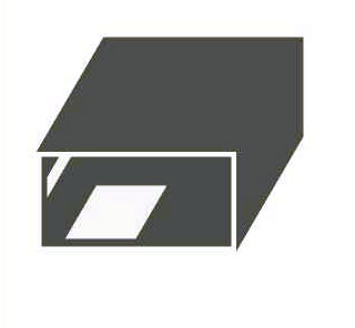

                lewiswadsworth
                Yes, it works! But only if the transparent bitmap is only 99% transparent (I Made it in Photoshop using layer transparency before exporting as a PNG with transparency enabled). A fully transparent bitmap is treated as opaque in Su.
                transptest1.skp
                (it's invisible....)

                      I think that the empty PNG has to be bigger than 10 x 10 pixels for it to work. I once noticed that a 2 x 2 PNG made by myself didn't work, but a bigger one from the forum (by Alan Fraser, if I remember right) worked perfectly. I cannot say where the limit is. The 99% trick is a good workaround
