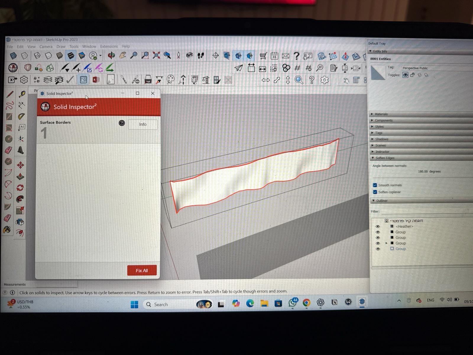

      i'm trying to create parametric walls with Curviloft and Flowify becasue thats what i learned from chat GPT 😁
      so i made the wavey wall with curviloft and after that i check the wall with solid inspector and it shows me that the edges aren't ok and i cant move forward.
      how do i fix that? if someone has a video for that it will help me a lot.
      thanks for the helpers.

        Difficult to judge without getting the model....

          What are you trying to achieve? Could you share any reference images?
          To use Flowify, it’s not necessary to work with solid objects, so there’s no need to check with the solid inspector. However, your wavy wall should be made of a clean quad mesh. If you created it using Corviloft, it should be fine, as long as the "top and bottom" and "left and right" curves have the same number of segments. Flowify requires quad geometry, not solid objects. You can verify this by turning on the hidden geometry.
          For additional guidance, you can follow this Flowify tutorial:
          https://www.youtube.com/watch?v=zCFUCE7Bb4Q
