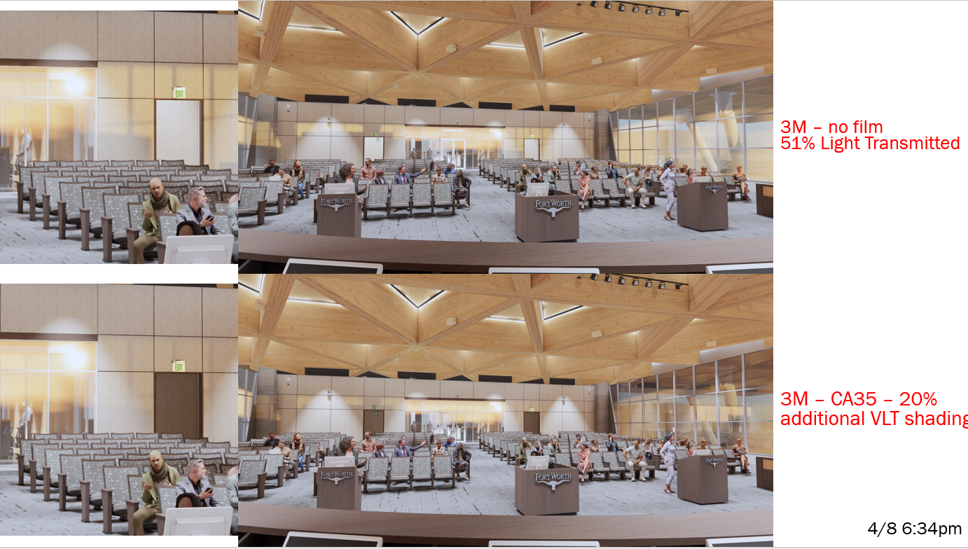

      I have been working with Enscape for the entirety of this project and we have come to a place where the client wants to occupy the building past the time they originally stated they would.
      Because of this the sun angles are letting the light through towards the end of the day and causing a glare on the backwall of the meeting space.
      I have been charged with testing 3M film that has the ability to cut the amount of "Visible Light Transmitted". Looking to see if 20% of VLT will take away the glare.

        I had ray-tracing turned off for the sun - didn't know that was a thing. - So, was able to solve the problem in Enscape.
