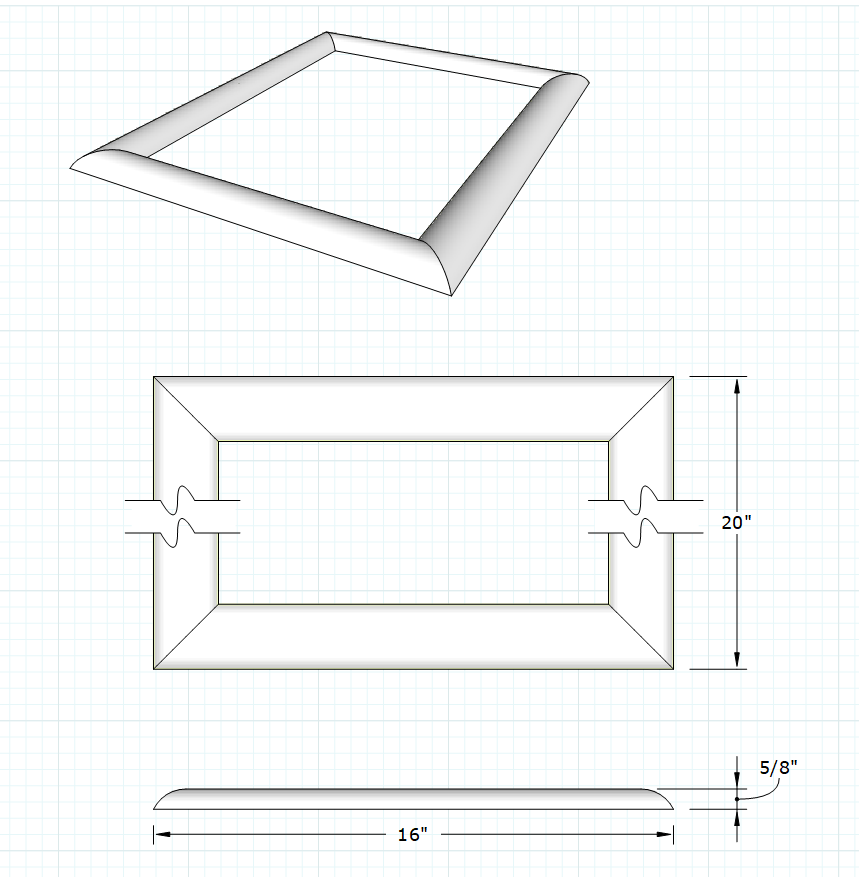

      Hi all !!!
      How do you get the exact thickness of, as an example, that kind of molding frame ? what is the real way to get it ?
      Thanks a lot !
      Pace!
      Thickness ???.pdf

        I would set up an edge-on scene and then, in LayOut, place the dimension between the bottom and the apex of the curve.
