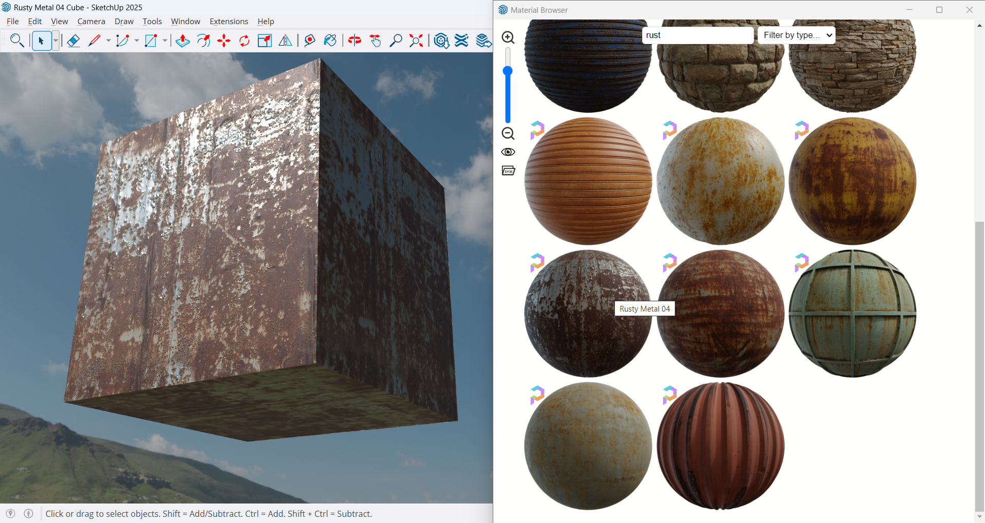

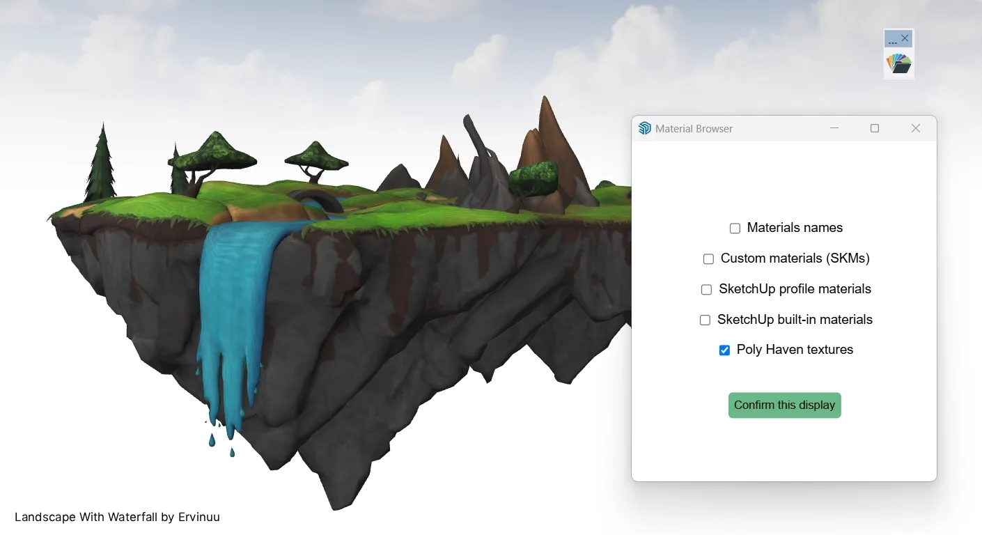

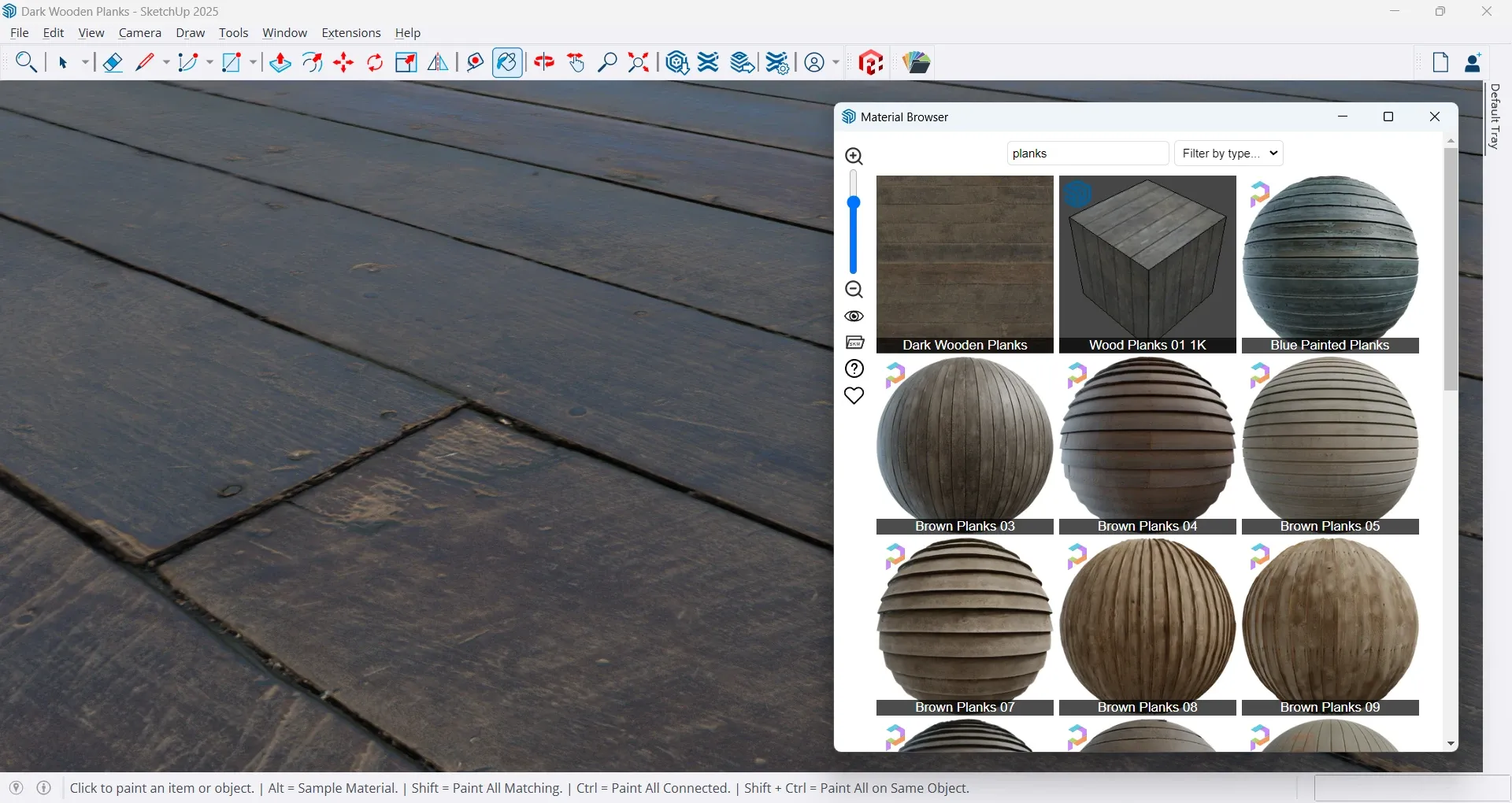

      Introducing Material Browser, a free plugin for SketchUp.
      Features
      • Search for SketchUp materials by name from:
        • Active model
        • Local collections
        • Poly Haven
      • Filter materials by type (Ceramic, Wood, etc).
      • Display larger materials thumbnails, up to 256px.
      • Select material of your choice in one click.
      • Support photoreal materials since SketchUp 2025.
      Screenshots
      Availability
      You can download it from the SketchUcation PluginStore.
