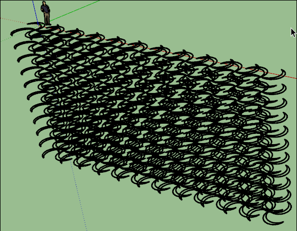

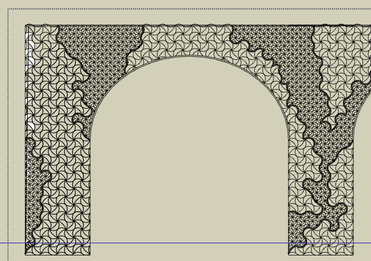

      semiru
      Is there a faster way to turn these lines into faces (flat bars 25mm by 3mm thick) without doing it line by line using the powerbar plugin? I want to create a pattern like this
        If your faces are "plane" just use Generate Faces (right Click Contextual) by Fredo Tools on Surfaces
        (if i well understand the question - that is not sure πŸ˜„
        If it's for Multiple extrusion Joint Push Pull Interactive by Fredo6

              I need to turn the lines into some sort of 3D flat bars to create a visible rendered pattern
                This or This or ... ?
                MC Escher Spirite! 😎
                Without image it's very difficult to imagine what do you want! πŸ˜„
                Line 2 Tubes by Didier Bur
                for bottom one!
                Can be applied to your all image in one pass (surrely very long calculus) πŸ’š
                So better calculate one then to make some Dim repeat πŸ€“
