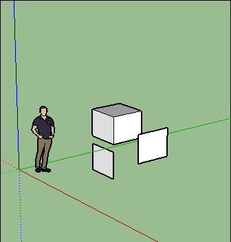

      Hello, I am having a bit of an issue. I downloaded a huge model from the Sketchup warehouse and I am having trouble with lighting. I realized the problem stems from the fact that all the windows are flat, which is to say that they don't have volume. I could go through with the push/pull tool and select them one by one and double click but that would take an eternity (there are dozens of windows.) Is there a faster way of doing this? I wish there there was a plugin just that would take transparent surfaces and let you add volume to them if they were only single sided. Thank you in advance!

        I have not tried this, but selection tools could probably help with the selection option you want, then (when selected) joint push pull?
          ...or Projections by Didier Bur for PushPull multiple! πŸ˜„
          and the famous last icon as Extrude Line(s) 😎 (not used in this video)
