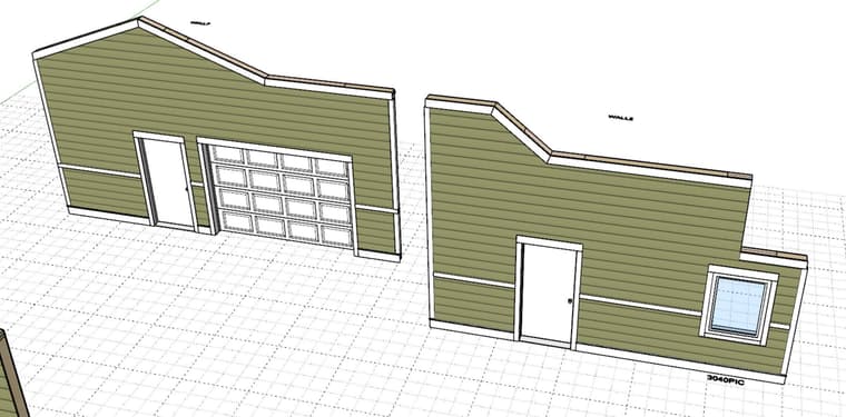

                              • medeekM
                                medeek
                                The recent update with the gypsum option (miter) needed some further attention. While I was sorting that out it became obvious that, along with tee intersections, columns that are not full height need to have the ability to cut out the gypsum, sheathing or cladding when the column is less than the full height of the wall.
                                http://design.medeek.com/resources/images/wall_su208_800.jpg
                                Note that the advanced options for columns allows the user to specify which element to trim away as shown in the column edit menu above. In some cases the beam may project through the wall to the exterior of the structure. In this case one would want to cut away the interior gypsum, sheathing and cladding as shown. The exterior gypsum is referring to interior walls with gypsum cladding on both sides.
                                Nathaniel P. Wilkerson PE
                                Medeek Engineering Inc
                                design.medeek.com
                                • medeekM
                                  medeek
                                  Tee intersections will now automatically remove the gypsum where the walls meet:
                                  http://design.medeek.com/resources/images/wall_su209_800.jpg
                                  The algorithm which notches out the top plates is very similar to this algorithm, which notches out the gypsum. For interior walls, as shown above, the tee intersection may be on either the "interior" or "exterior" of the wall. Hence the algorithm needs to be smart enough to detect which side of the wall is being affected and notch the appropriate gypsum wall panel.
                                  Further refinement is probably in order since the result is not a true mitered corner however it is a start and certainly and improvement from when tee intersections were simply ignored with the gypsum.
                                  design.medeek.com

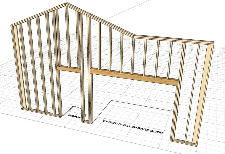

                                  • medeekM
                                    medeek
                                    The number of garage door types and variants is almost exhausting, yet another plugin within a plugin. To begin with I will start with the following door types:
                                    • Solid
                                    • Panel (Panels will consist of 18" or 21" panels (or metric equivalents: 455mm, 525mm) arranged in such a way to allow for 3" (70mm) increments in door height.)
                                    • Standard Raised Panel
                                    • Long Raised Panel
                                    • Standard Flat Panel
                                    • Long Flat Panel
                                    • Glass Standard Raised Panel (Glass indicated that the top panel will have glass inserts)
                                    • Glass Long Raised Panel
                                    • Glass Standard Flat Panel
                                    • Glass Long Flat Panel
                                    • Full Glass Standard Panel (Full glass indicates that entire door is glass)
                                    • Full Glass Long Panel
                                    There are many other garage door variants: Carriage doors etc... those will be added per user request.
                                    design.medeek.com
                                    • jujuJ
                                      juju
                                      If you could build these child plugins in a way that a person could do a basic execution of whatever and could purchase the child plugin for the additional functionality it may be a good indicator of demand for the child plugin while bringing the main plugin cost down (thus more accessible) and a separate income stream from the child plugin (which may or may not be able to be used on its own).
                                      • medeekM
                                        medeek
                                        Slowly working through the garage door module. Here is a first look at the garage door casing:
                                        http://design.medeek.com/resources/images/wall_su210_800.jpg
                                        (Painted blue for emphasis)
                                        With this new module I'm getting things right from the get go. Materials options are incorporated from the new Material Library so that piece of the puzzle will be much more streamlined and easy to use.
                                        Since I am working through this a little more slowly (and carefully) it may be a few days before I release any fixes, I apologize for the delay.
                                        As I mentioned in a previous post I have broken garage doors out into their own separate container, as such garage doors have their own edit menu etc... this is a little bit more work but will result in more flexibility and long term improvements will be more attainable.
                                        design.medeek.com

                                          • medeekM
                                            medeek
                                            So here is what I have for the garage door callout so far:
                                            http://design.medeek.com/resources/images/wall_su211_800.jpg
                                            The second (smaller) line of text will display the header/lintel size:
                                            Glulam headers will display the glulam dimensions and the term "GLULAM BEAM"
                                            A typical lumber (nail lam) beam will be: (2) 2X8 LUMBER BEAM
                                            A typical LSL Callout: (2) 1-3/4X7-1/4 LSL BEAM
                                            I'm sure everyone has their own favorite way of making these callouts and I need to figure out a way to allow for enough flexibility but at the same time to not over complicate the matter.
                                            The dashed line shows the footprint of the overhead door, with its depth equal to the door height.
                                            Please feel free to chime in with suggestions or concerns.
