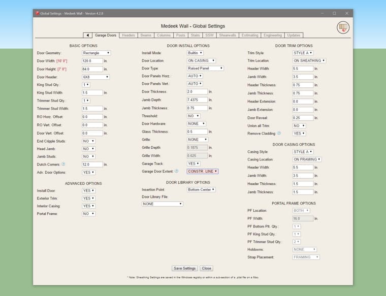

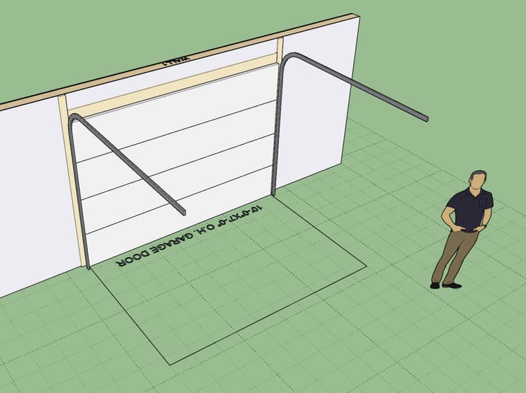

                          Version 4.3.7 - 02.28.2026
                          • Added a "Garage Door Extent" option to the Garage Door tab of the Global Settings.
                          • The garage door extent symbol/outline can now be removed or toggled between a dashed (construction line) or solid line.
                          This update per customer request.
