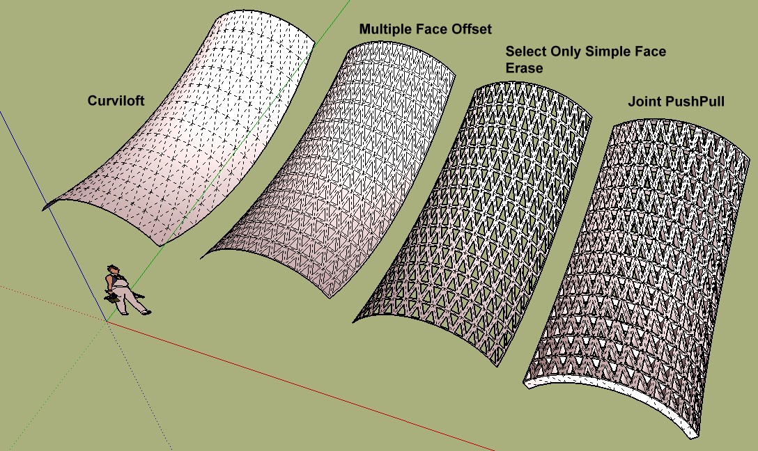

        You can natively but that will be some painful! πŸ’š
        Try this wonderful Flowify! 😎
        Flowify by Caul πŸ˜‰
          TGI 3D is also a candidate πŸ˜„
            And also Su4 to component! πŸ’š
              CurviLoft + Joint Push Pull + Multiple Face Offset + Select Only Simple Face! πŸ˜„
              etc...
                Surfoyu
                Extrude Tools by TIG
                Weld curve : Recurve by Digssey
                Extrude Tools by Tig
                http://s6.postimg.org/3l53mfuxd/suforyou4.jpg
                Surfoyu
                http://s6.postimg.org/gdt7md6j5/suforyou3.jpg
