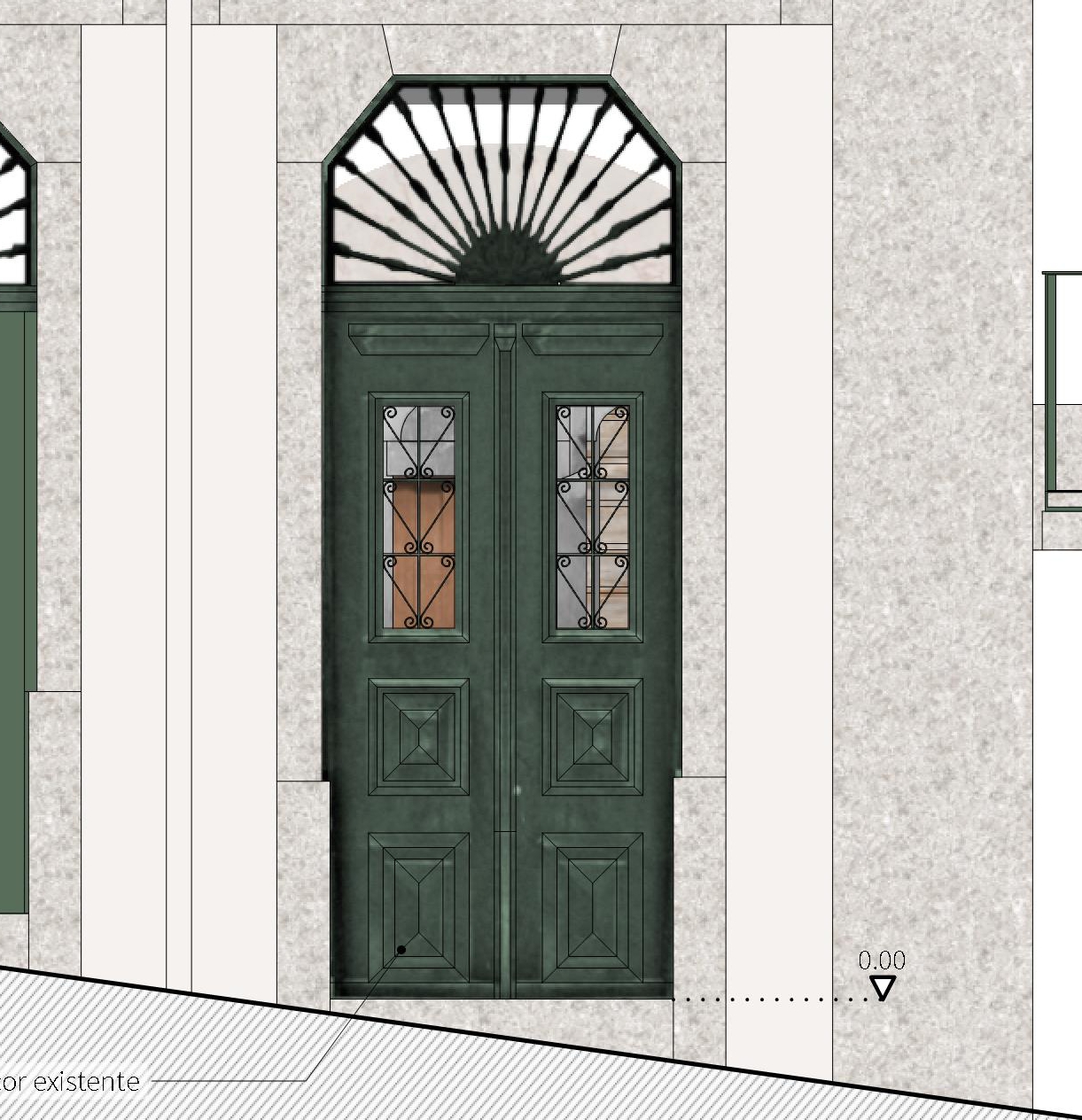

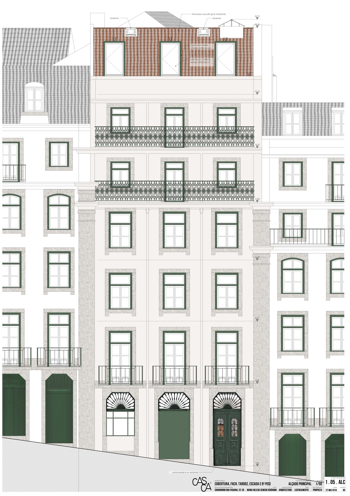

            I haven't used it very much latelly, I've been finding other ways of modelling my buildings from photos.
            What I now do is adjust the crop photos in Krita and deform them to confine to rectangles. They don't even have to have the right proportion. They just have to be vertical and horizontal.
            Then I import them to sketchup draw a rectangular shape in top of them wich I know the correct dimensions, scale the texture to that shape and sample the texture to a wider face.
            Then I have a correctly scaled texture wich might be a façade or simply a door or window.
            I then compose my building with that method for all sides. It's much more accurate, easy and controlable, as you don't need to work inside a static "2D" scene and in the end results you can make it look better:
