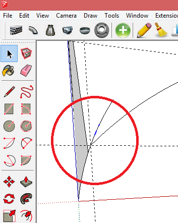

      I draw an arch near an edge, it merges with it and becomes particles how to avoid it?
      • pbacotP
        pbacot
        Group the separate entities to avoid interaction.
        • V
          VaalKIA
          It has helped, after ungroup, also everything is all right
