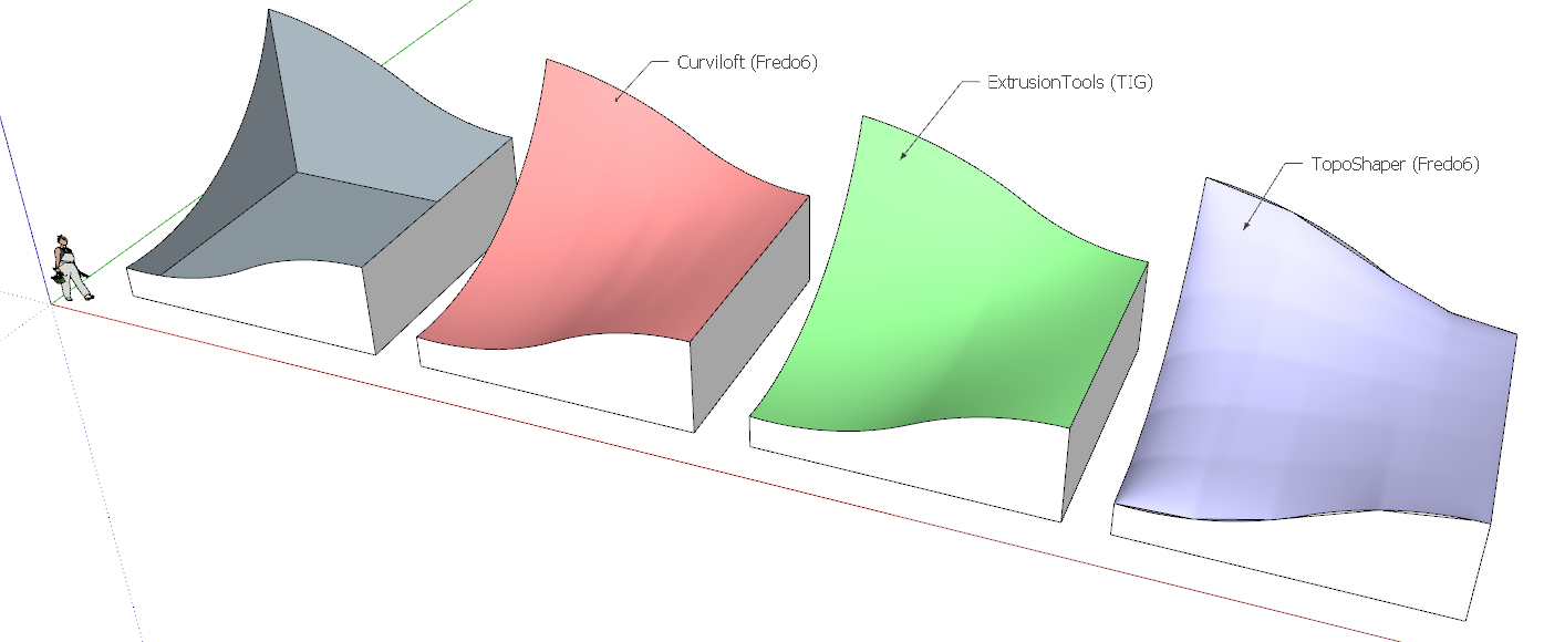

        There are different plugins available to create that surface, e.g.

          Thanks cotty, now I have a wider range! can you make some fast video how to do it with curviloft and Extrussion tools? Maybe some link?
          • cottyC
            cotty
            Something like this?
            https://www.youtube.com/results?search_query=curviloft
            https://www.youtube.com/watch?v=0lmLHyhTIBM
