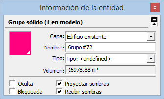

      I need your help. I'am beginner and need change color to entity group by Ruby.
      I Attach the entity that I need change color.
      How can find this object and then change color?
      Thanks.
      Best regards, from Argentina!
      entity

        You need to find the group.
        There are several methods, depending on how your 'tool' is getting its information...
        a. group = Sketchup.active_model.selection[0] assuming one group is selected...
        Assuming my_name = "Grupo#72"
        b. group = Sketchup.active_model.active_entities.grep(Sketchup::Group).select{|g| g.name = my_name }[0]
        which gives you the first group of that name in the current active entities context...
        c. named_groups = [] Sketchup.active_model.definitions.select{|d| d.group? }.each{|g| g.instances.each{|i| named_groups << i if i.name == my_name }}
        Now you have an array of all groups named ' my_name'
        Often there will be only one... but you CAN rename several groups with the exact same name !
        If you are sure then there'll only be one, then group = named_groups[0]
        Let's us assume you have a ' group' reference...
        Now you need to get a material...
        There are several ways to get a reference to the material...
        Assuming my_material_name = "My_Lovely_Material"
        a. material = Sketchup.active_model.materials[my_material_name]
        If it returns nil then it doesn't exist.
        Otherwise it's a reference to that material.
        b. To make the new material use:
        ` if material = Sketchup.active_model.materials[my_material_name]
        do stuff with 'material'
        else ### make the new 'material'
        material = Sketchup.active_model.materials.add(my_material_name)
        material.color = [123, 123, 123] ### some RGB value
        end`
        Now you have the references to the group and the material, use them thus...
        group.material = material
        There are many ways to skin a cat... πŸ˜‰
