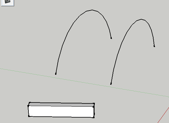

          This picture show that I have first : (Two lines => the path, and a shape (group) to copy on the path)

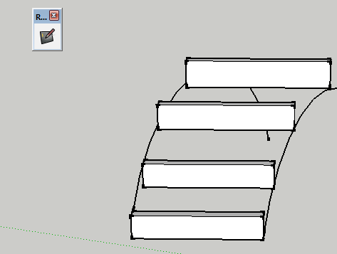

          And here the result :
          • TIGT Offline

            If you want to 'swivel' each box to span between the nodes in one curve and the equivalent node in a second curve, then you need to assemble two arrays of points - says points1 and points2
            You iterate thus:
