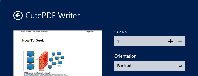

        I don't know what's wrong with your file or how to fix it... However, you might try printing to PDF instead of exporting. That's what I do. Mainly because of file size. There's a few ways to do it.
        http://www.howtogeek.com/150891/how-to-print-to-pdf-in-windows-4-tips-and-tricks/
        Methods that they don't tell you about are PDF995 and Adobe's own PDF printer that comes with Acrobat XI or Acrobat X
        CutePDF
        http://www.cutepdf.com/
        Adobe Acrobat XI
        http://www.adobe.com/products/acrobat/print-to-pdf.html
        PDF995 Free
        http://download.cnet.com/3028-6675_4-10068482.html?c=CBS-AUS%26amp;s=fivemill%26amp;pid=dlcom_sem%26amp;aid=10068482_12666223634_332621340%26amp;dlc=n%26amp;part=fivemill
        PDF995 Paid Set
        http://www.pdf995.com/
