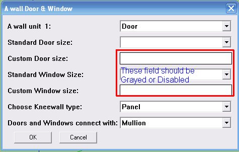

      Hi someone help me how to disabled or grayed some field in inputbox. For example I have drop down to choose for door and window in Inputbox. When user choose door then window field need to be disabled or grayed. how do i can do that? please see my attachment.

        There is no such control for UI.inputbox.
        If you need advanced control over the UI the only option at the moment is to create WebDialogs.
        That being said, you might find it easier and faster to make a dialog using the SKUI framework: https://github.com/thomthom/SKUI
