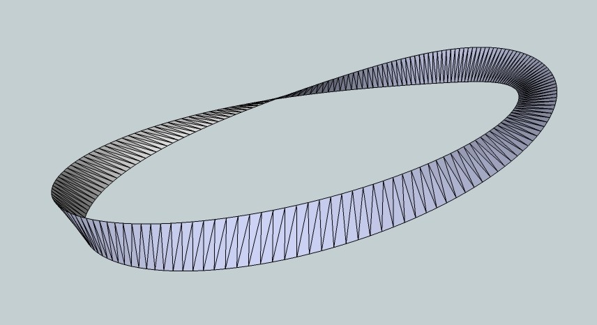

        • I
          ipomea
          Thank you very much. This has really been helpful. It was OK the first time I tried
          This is the end result:
