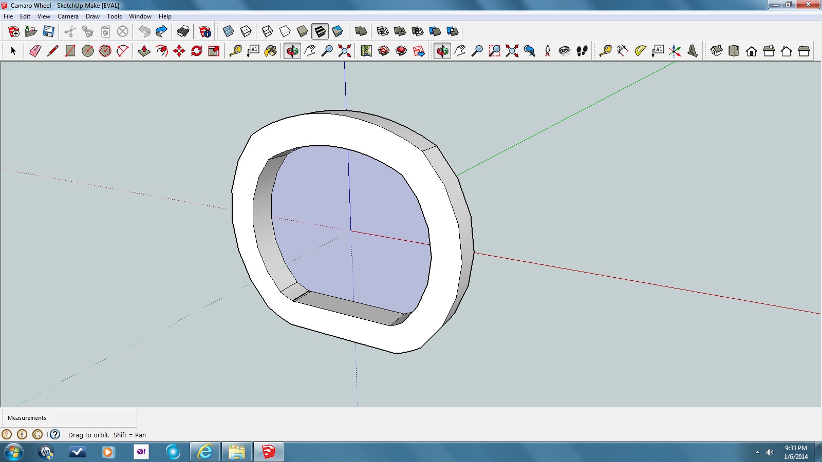

      I am trying to design a new steering wheel for my car and want to use sketchup to get engineer the parts. As I hope you can see in the picture this is the general shape of the wheel. But it needs the be curved along the edges. Any idea how to do this? I tried round edge and round corner with out success.

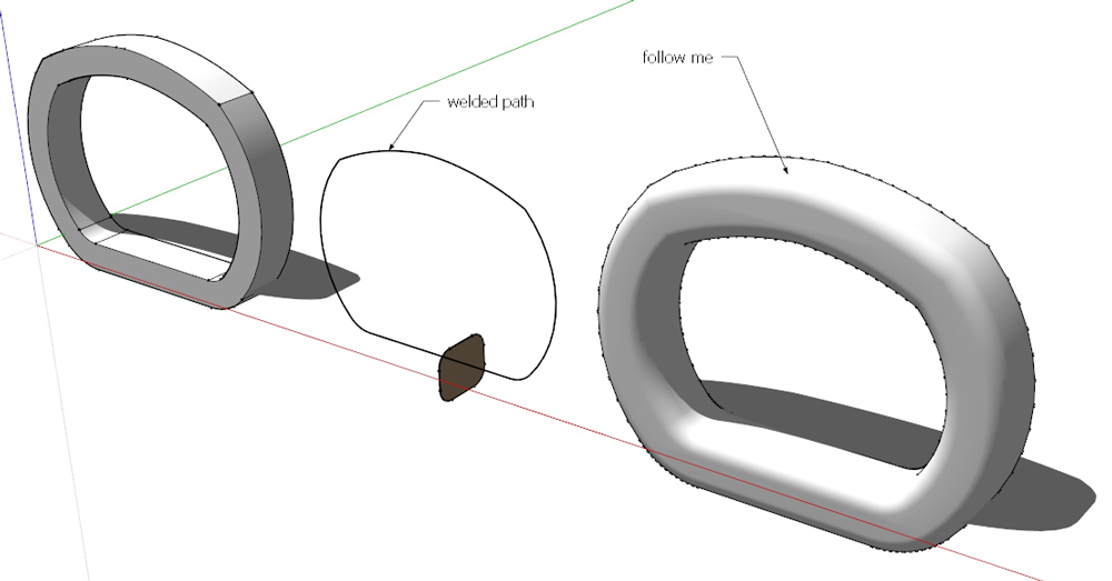

        One way without a plugin would be the follow me tool...
