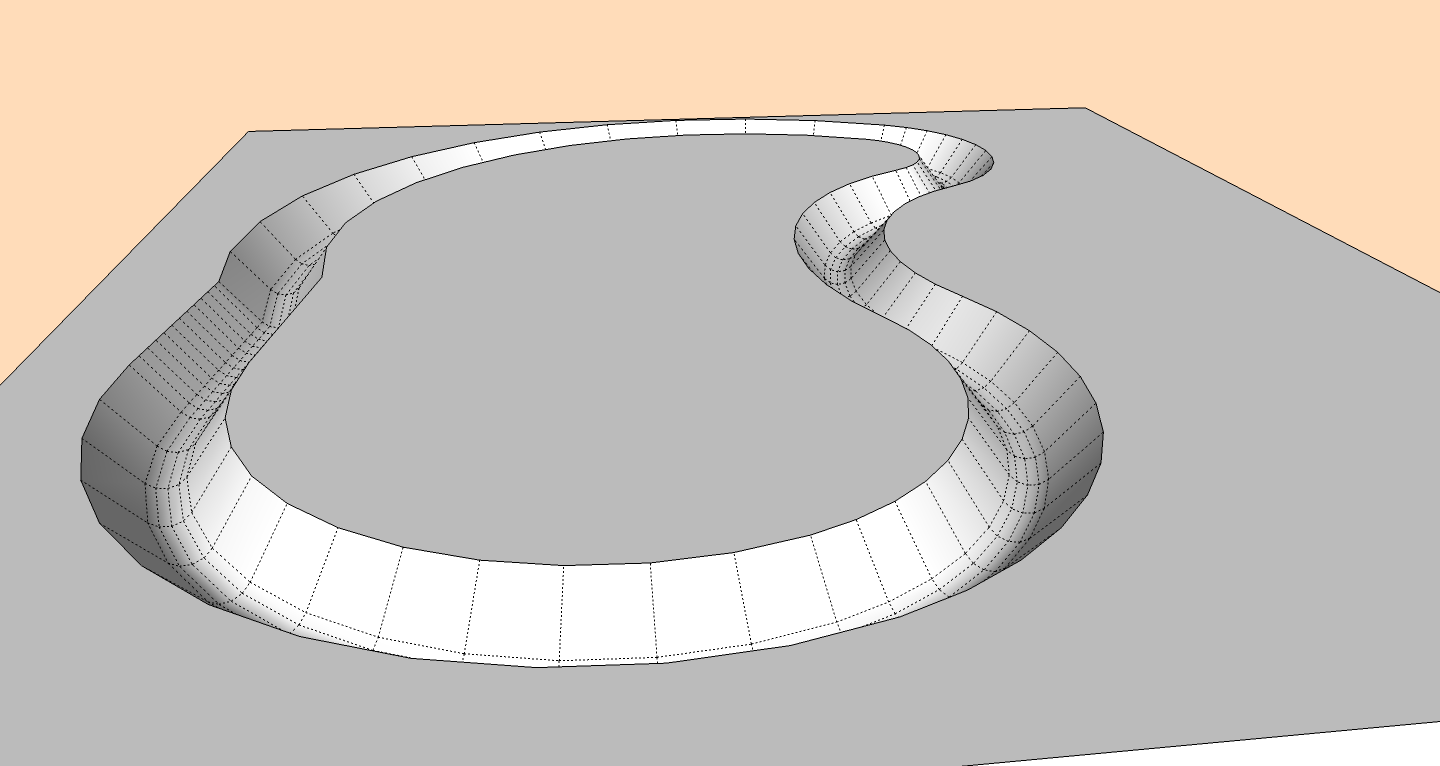

          Is this something like that?

            Another way. create a profile of the groove you want as a flat face and use that with the follow me tool along your line. This is what Gilles has shown above.

                Ye what Gilles has posted is pretty similar except the line will generally go from one side to another (not necessarily opposit side, may wind around the face and go to the side on the left for example). Rather than being a loop enclosed in the face.
