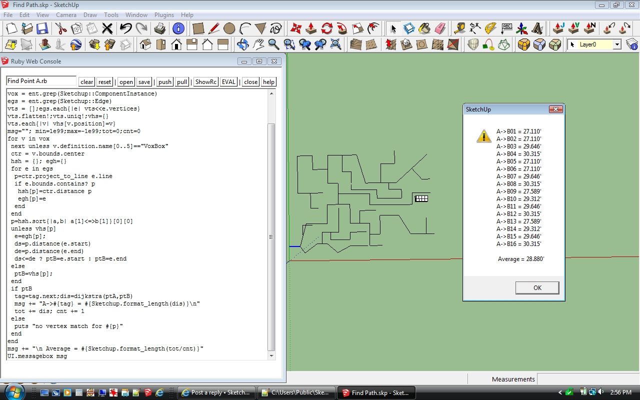

                            The voxels are component instances with a .definition.name prefixed with "VoxBox" so it is no problem to find them and use the .bounds.center to define its location. Then it is a matter or projecting that point to each edge of the network to find the closest edge. But, unlike a vertex, the point isn't associated with the edge in anyway that would allow you to retreive the edge and traverse back to point A. The best results I have been able to achieve so far required dividing the edges then picking the vertex closest to the projected point and using that as point "B"
                            http://sdmitch.blogspot.com/
                              Fire a vector from the bounds.center using:
                              Geom::intersect_line_line
                              or Geom::intersect_line_plane
                              or use Model#raytest()
                              I'm not here much anymore.

                                I have been working on something similar and have had some success with Dijkstra's algorithm. This is my first project with SketchUp and Ruby so my plugin has been built by trial and error and isn't very pretty.
                                The Calculate Shortest Routes command in the Plugins menu writes the results to the Ruby Console window. There is another command that writes the results to a .csv file.
