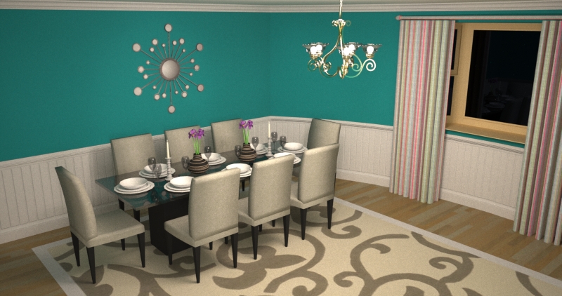

      I have a some problems when I'm rendering this scene:
      1. I have imported a carpet from 3D Warehouse and I quite like it's pattern.
        The carpet wasn't visible in Maxwell so I made it into a face. What properties of the material I should change in Maxwell so that it looks more like a carpet than a flat image?
      2. The chandelier appears to be too bright even though the overall exposure is not bad I suppose. How can I make bell sconces more visible(they are yellowish originally) and chandelier to be more like a chandelier than a bright star on the ceiling?
      3. The scene was rendered at SL20, but there are still a lot of white dots.
        Should I make a roughness of all the materials less(walls & panelling)? The window , sconces, bulbs - all use AGS, White panelling is (230, 230, 230). The mirror on the wall is has a texture image in SU and uses Maxwell->Material->Character->Automatic setting. So it shouldn't render it as a mirror for now ( as far as I understand). What can cause white dots appearing all over the place here?
      If you can give me any other advice how I can improve the scene and make it more realistic, I'd really appreciate as it's my first trial and I really need to learn a lot!

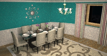

            I'm sorry to say that I just don't think the “Draft” engine is up to the task of a scene like this – I tried a bunch of things, and there were some issues, but fixing them had little impact of the draft engines output... at the end of the day the draft engine still can't clear the noise within a reasonable time/SL.
            Draft engine SL18
            If this is the type of scene you need to render often I think it really is going to be needful to use the production engine – which can do it no problem (see attached example).
            Production engine SL14
