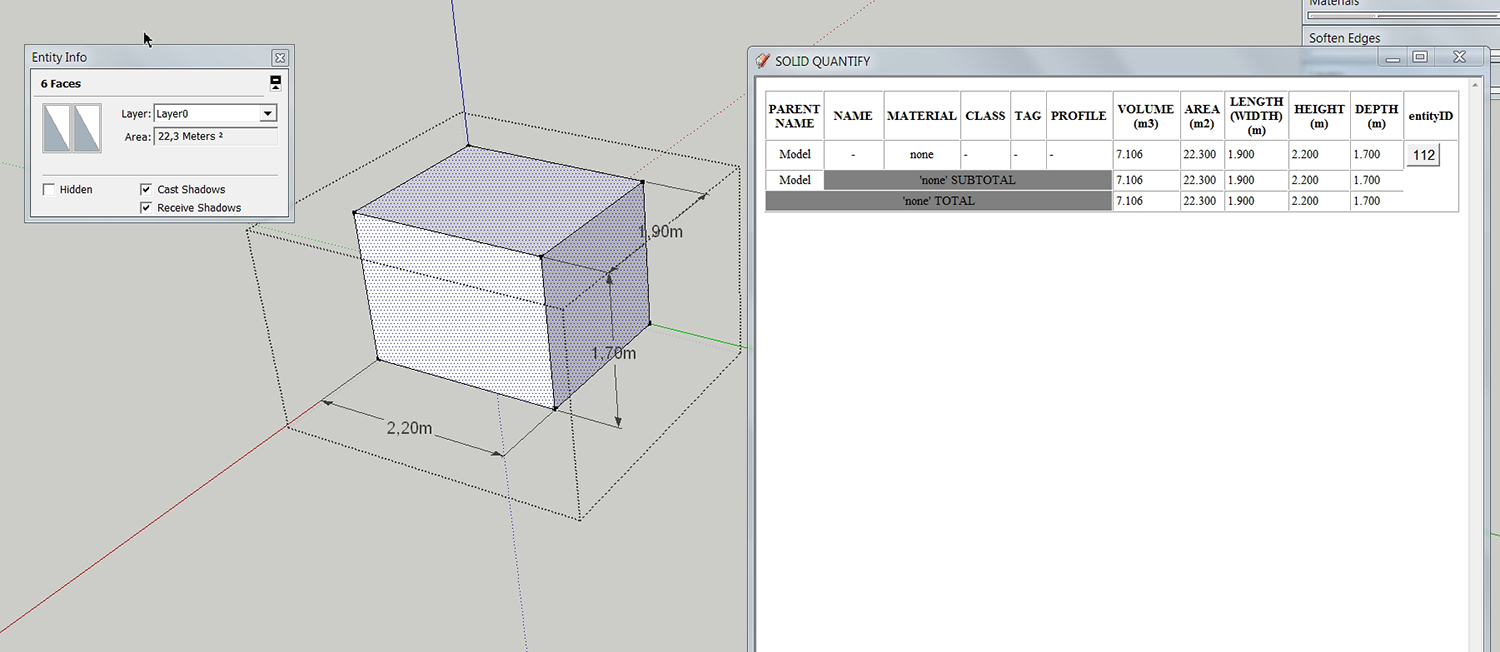

        Hi Tobias,
        have a look at this thread
        http://forums.sketchucation.com/viewtopic.php?f=323&t=41120&hilit=plugin+solid+quantify
        for flat surface(s) select your surface(s) (without edges) and open Window-->Entity Info.
        Charly
        • GaieusG Offline
          For solidgroups/components, the entity info will also report the volume. For a selected set of edges (or just one), it will report the length.
