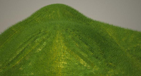

      It could have something to do with the irregular shape and distribution of the subdivision. I just made a 10x10m patch (subd every 0.5m) using the sandbox tools and here is the initial result:
      As you can see there is still some slight artifacting from the subdivisions, but not as bad as yours.
      To alleviate this I added a copy of the same geometry set .01m below the current surface with the same grass settings except the Density>Seed value set differently -- this is the only current way to "stack" grass modifiers like I would in Maxwell Studio, but as you can see it does the trick pretty well (aside from slower renders):
      I would definitely prefer to do these types of things in Maxwell Studio (for now) so as to avoid duplicate geometry (and all the render costs it incurs)... I typically stack 2-5 grass modifiers for any scene I'm doing with grass.

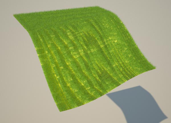

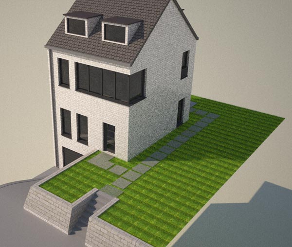

            I was not able to reproduce what you did with the sandbox tool. Also, when I apply the grass tool/ texture on a flat surface, very visible straight lines appear. Am I doing something wrong here?

              I've never seen anything like this before -- can you post a sample file for me to look at?
              Best,
              Jason.
              I create video tutorial series about several 2D & 3D graphics programs.
              • jason_marantoJ Offline
                jason_maranto
                OK, so this was pretty easy to fix -- some of the issue was the way materials were used and (potentially) some of it was geometry.
                Basically the main issue was the use of the grass MXM material -- that MXM should only be applied to the grass modifier itself -- the base geometry needs a completely different material... I used a simple solid brown "dirt" material here, but you can get as fancy with that as you want.
                The next thing is you do not want the grass geometry to go beneath other objects (like the walkway slabs) or the grass may grow "through" them as well... Here I just went into your grass group and deleted any geometry below the slabs.
                I also made some modifications to the main grass modifier but that was only for my aesthetics πŸ€“
                I'll PM you the edited file so you can look it over.
