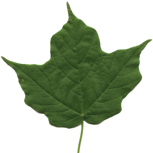

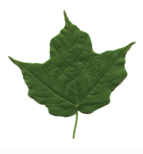

            I have just grabbed this image from the Internet. Notice that the background is completely white so it is easy to select with a tool called "Magic wand".
            In Paint.NET, after selecting the white pixels, you do nothing but press the Delete button and save the file as PNG (with 32 bit). I also cropped it to the extent of the leaf...
            Note however that SketchUp will not be able to cast a leaf-shape shadow but transparent pixels will also cast shadow - this means that your leaf shadow will be rectangular. I am not sure if this is an issue since if you add some more edges to draw around, model complexity (with lots of leaves and trees) may slow SU down considerably.
            Import both into SU and see the difference.
