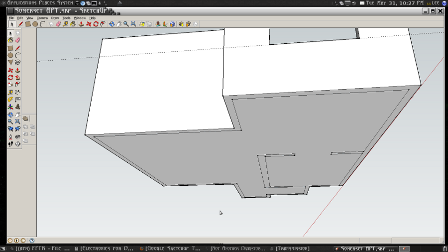

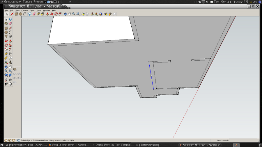

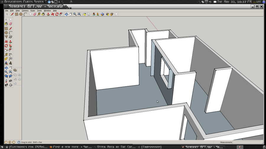

      Hello all, i cant seem to take the lines out of the bottom of my floor without erasing a wall. i've included a picture. the view is looking up at the bottom of the floor.h
      bottom of floor
      selecting line
      results

        Pull the floor down so it has thickness, similar to how your walls look...right now your floor is just a single face.

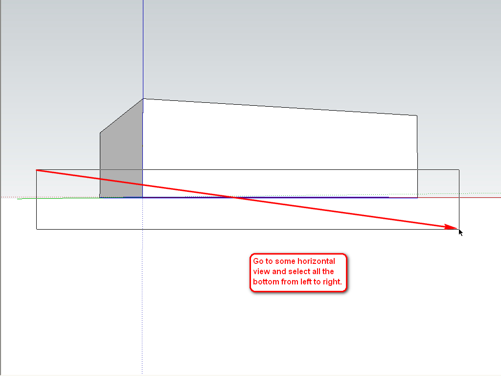

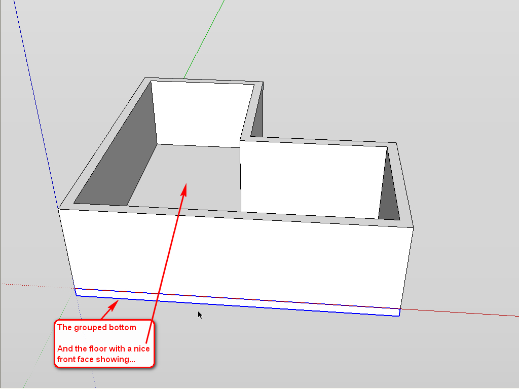

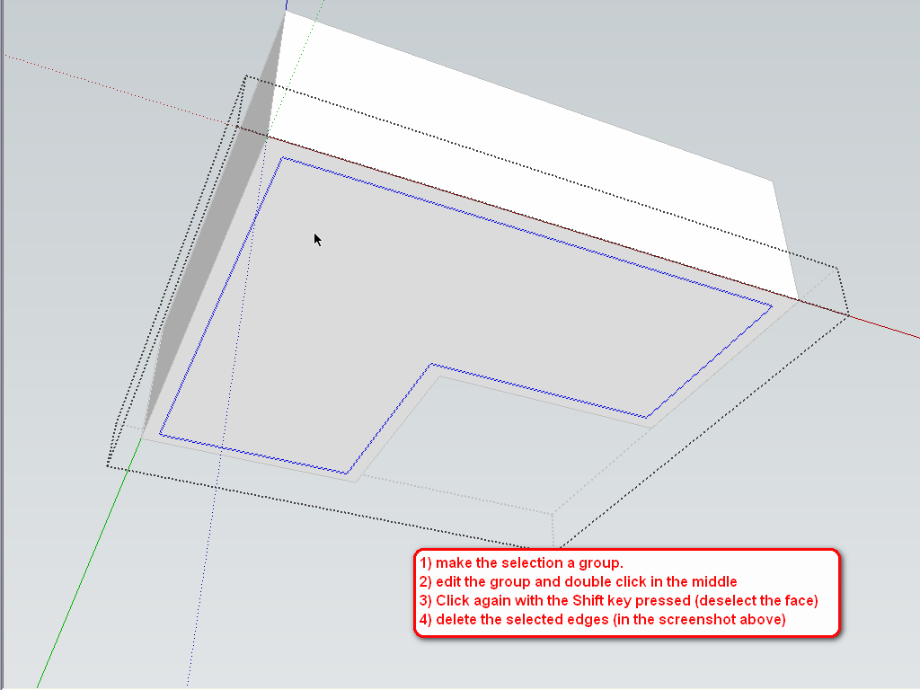

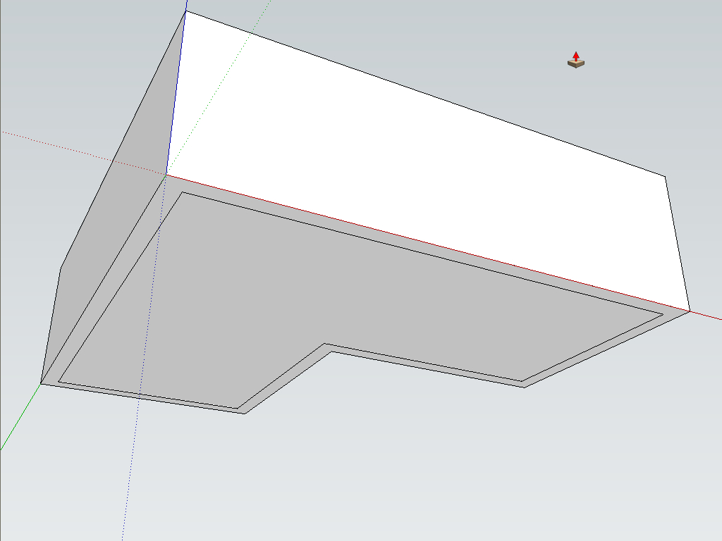

          Well, you can hide those edges with the Shift+Eraser tool but actually you should indeed model some thickness for the floor, too - just like in real life. For now, I would suggest to make a group of your bottom face(s) and give them some thickness like below...
          This selection and deletion of the inner edges can be one in a variety of ways - also depending on your model. This is just one of the ways suitable to my example.

              ok sweet i got it thanks
