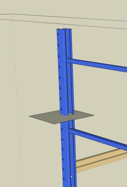

        Its not too hard...
        -Open the upright group for editing
        -Make a square/rectangle on the ground plane just a little bigger than the cross section of the upright. You will use this square as a "knife" to cut the upright
        -Group the square and center it on top of the upright, then move it down 24" (see picture below)
        -Explode the square's group, then select it -> Right click -> Intersect with context
        -Now you should have a seam at the correct height, just delete the square and the unwanted portion of the upright (this part worked best with hidden geometry on for me)
        That's it!
        Click image if you see scrollbars...
        http://goo.gl/f7ooYh

          Worked perfect! Thanks for the help.

            You're welcome...and FWIW, the solid tools in SU Pro wouldn't have helped in this case, as the upright that you are cutting isn't solid πŸ˜‰
