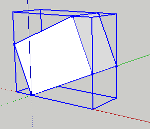

      I have been working on the appearance of rotating a bounding box while keeping its component in place. I have succeeded in doing so one axis at a time, but am having problems doing it properly with all three axis at once. Attached is a portion of the code that results in appearing to transform a component's bbox, without rotating the component. I originally thought that I could rotate the component 3 times, once in each axis, but I later realized for obvious reasons was wrong. Any ideas?

      Test component bbox rotating z around y
      After aligning component with world axis, transform_entities the component back to original transformation.
      I first tried this in "point component", and although it functions, it not because I did it properly, but because the particular sequence of commands I used, works within a limited situation.

            I went from here:

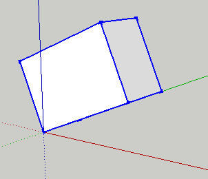

            to here by Geom::Transformation.new(pt, axis, angle):

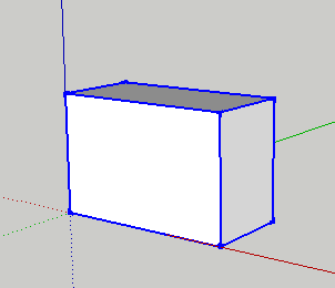

            then to here by ent.transform_entities(transform,ent1,ent2,ent3):
            But how do I do step 2 for a component rotated on all three axis?
