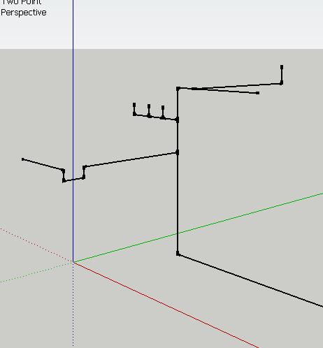

      New here,also new with SketchUp, what I am trying to do is draw a simple isometric one line plumbing drawing without needing to create my own fittings, that would take waaay too much time, hope someone has a solution, thanks.

        SU is a 3d program that can view its 3d models in various perspective, or parallel projection. The images below however, are unscaled bit mapped, not scaled vector images.
        2 point perspective
        Parallel projection
