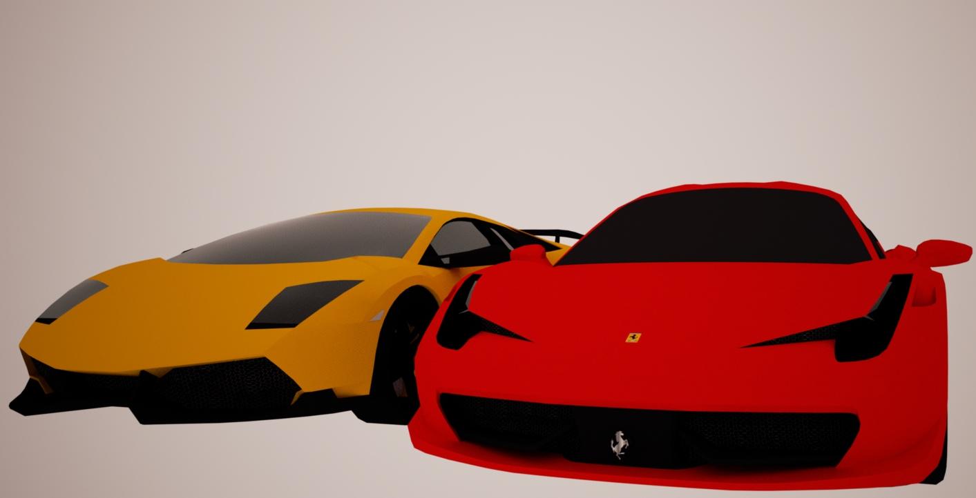

      1. I need some help with rendering cars. I get them rendered, but the headlights and rear lights just turn black so you dont get to see the high details inside the headlights. Why is this happening?
      http://www.facebook.com/photo.php?pid=31612960&l=1bd840c052&id=1112149337
      http://www.facebook.com/photo.php?pid=31612893&l=b942d24aec&id=1112149337
      look at the black headlights and rear lights

      pic of the cars headlights

        For headlights put some very reflective material inside them, like chrome for example.

          so its just that? chrome and you'll see through the black glass/plastic?

            It depends on the material's properties how well you see through them,you should try more materials and tweak their settings, but basically to see inside you need a clear glass material, a reflective chrome like material on the inside and or an emissive material for the lights.
