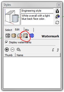

          You could add a watermark image under Window > Styles and set it to show in one corner...would that work?

            Perfect! Thanks guys.
