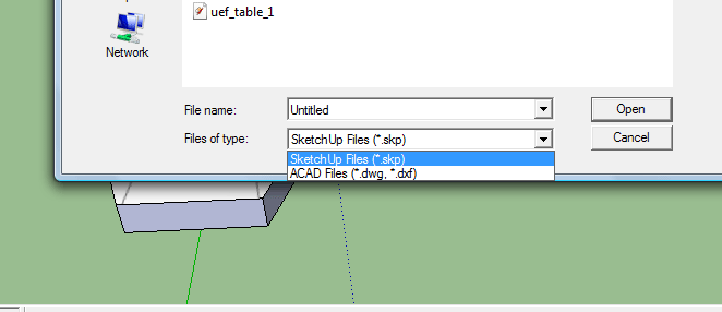

      Hi I am new to sketchup, and have been watching many videos to learn how to model, and have learned most of the things i need....
      .... but I am having a problem with textures...... I want to import a jpg as a texture, but all the videos on youtube are made on macs, they say "select face - goto file import - import jpg as texture" i get as faer as "goto file import" but i dont have an option to import jpg files... just skp,dwp,dxf.... do i need a plugin or am i doing something wrong?
      I am using sketchup pro 7.1 on windows vista

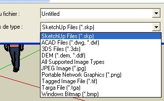

        Curious all that you say is 3D !
        Have you scroll this list?
        2D formats are normally after the 3D format! (PC screen)
        • Z Offline
          zordork
          [attachment=1:3rga4dw2]<!-- ia1 -->jpg.jpg<!-- ia1 -->[/attachment:3rga4dw2]
          I dont get any of that all I get is:

            This is interesting, my import choices have 12 selections (including Google Earth Files, and Photo Shop), Pilou's 10 and yours 2.
              I have SU V6 free, maybe this explain that πŸ˜‰
              • honoluludesktopH Offline
                honoluludesktop
                I don't know, but because of zordork's 2, I suspect something else is involved. Maybe the OS.
                • GaieusG Offline
                  Nay, guys, the import options should be there. Zordok, I wonder if your SU installation has gone wrong somehow. Could you try to reinstall SU?

                    zordork
                    managed to imported a jpg now, thanks guys. but 1 more question, is it possible to layer textures on the same surface.. (IE. paint graffiti onto a brick wall)
