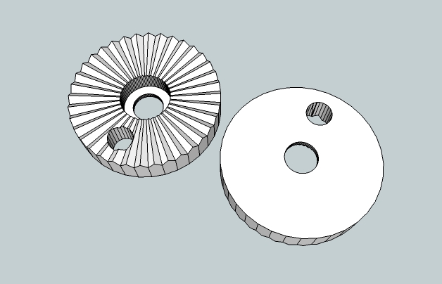

      I am an inventor of electronic drum instruments, and I used Sketchup for almost all of my Patent drawings. I am trying to manufacture some of my instruments, so I bought Sketchup Pro thinking that I could produce DXF or DWG files for CNC machining. I have been struggling with it for three days now, and all of my manufacturers are fed up with me sending them fatally flawed files. If any of you have done 3D DXF I am desperate for some advice. Please assume I'm pretty lame with all of this (you will be right). I will attach some files, and thanks in advance!

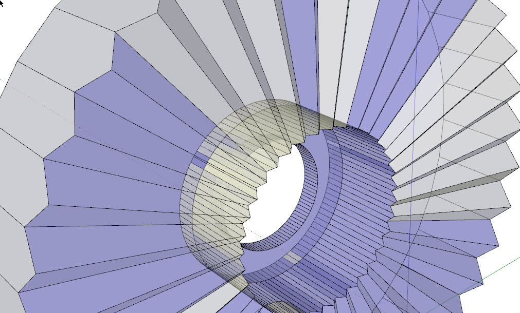

        first of all you should be working at least 10x bigger scale then just give the manufacturer the radius and he'll scale it for himself.
        but for now just get all your faces in the right direction (purple ones are backwards) and remove the inner faces where the arrow points. i would personally just make 1 segment (cog, tooth, whatever) make sure its good then copy/rotate the rest.

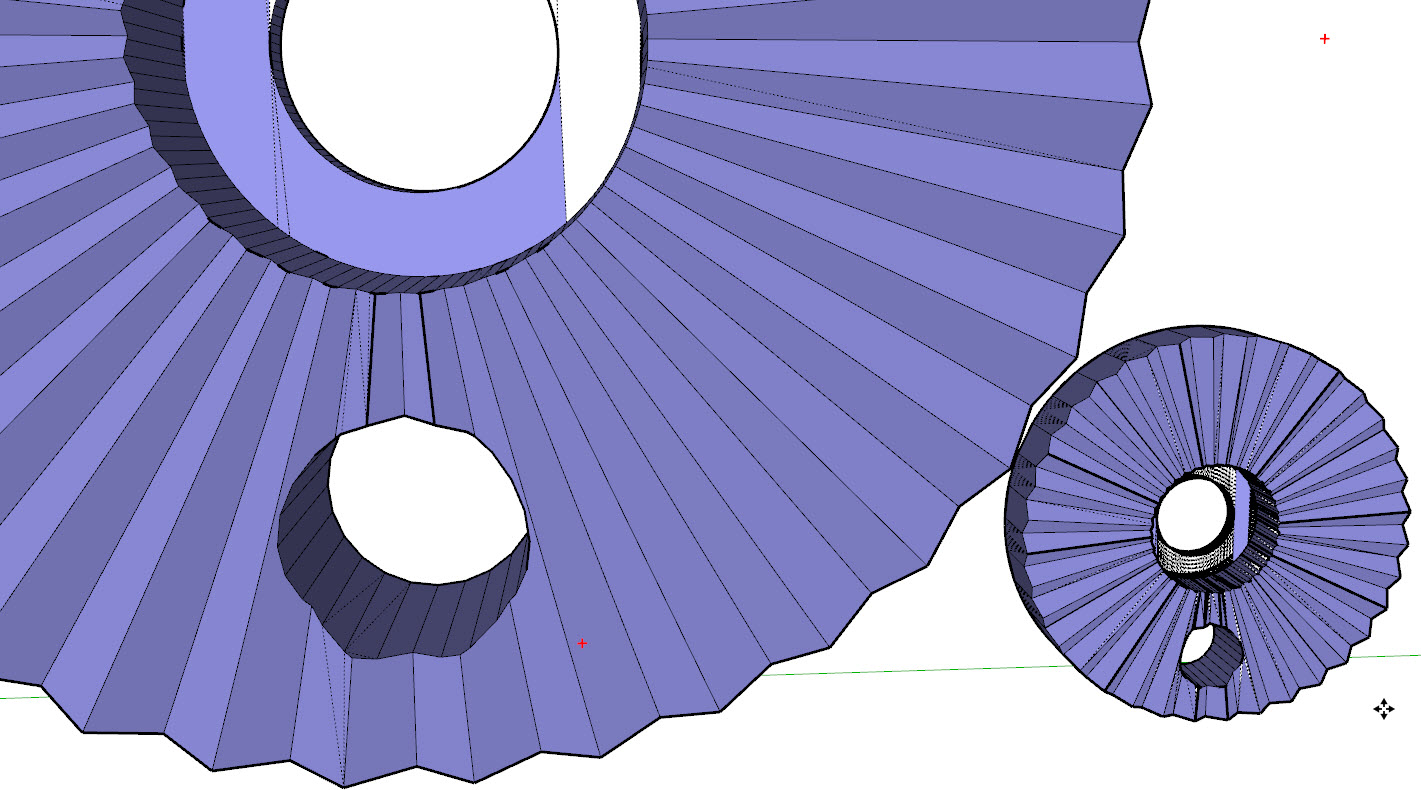

            one more tip. you can export to dwg then reimport to SU you'll see the mess (really try it, i did with your model) i'm pretty sure most of your problem is your small dimensions (SU doesn't work well with these) that's why i suggested working bigger then scaling down.
            here i copied and scaled one up, exported as dwg then imported back in. see the problems? the small original one is missing quite a few faces specially around the center... the big ones not perfect but i imagine it could be easily tweaked. 😉

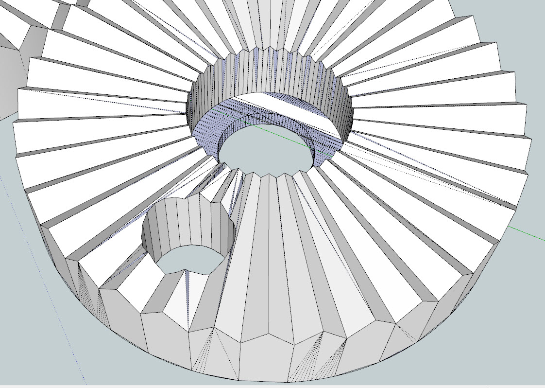

              Your almost there, Mark. I had a go at cleaning it up.
              • Scale up by 10 or 100 times.
              • There was a missing Face inside - need to hide the back face and have a look inside.
              • There was some superfluous geometry around the center hole on the back side.
              • Finally, oriented all the faces.
              • Scale down.
              • Export.

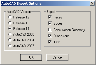

              Did you notice the export options available? Maybe there is something there that is causing problems?
              But as I said, the model was nearly "correct" and only needed a few minutes cleanup.

                nice try. this is what the dwg re-imported looks like! i don't think any manufacturer has time for this crap.
                if you serious and making money with your stuff buy a proper program to do this stuff for manufacture. yoiu need a solid modeler not a poly modeler. there are lots out there, some cheeper than SU (not the free version of course 😆 ).

                  But that's a SketchUp size limitation. It has nothing whatsoever to do with how the file will get imported in a cad program.
                  This is how my import looks in SketchUp. Imported in Feet, scaled to inches.
