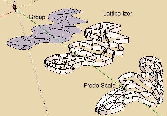

      WHY not? πŸ˜„
      See works by Bartels
      Make your form as "flat" then extrude it or better lattice-izer by TIG
      Then use Fredo Scale tool for deform it!
      Of course take a more big thickness than mine in the parameters of the lattice-izer πŸ’š
      If you want you bubble soap face, just make an intersection pan with the Lattice-izer result
      and give a tranparent material to the external faces
